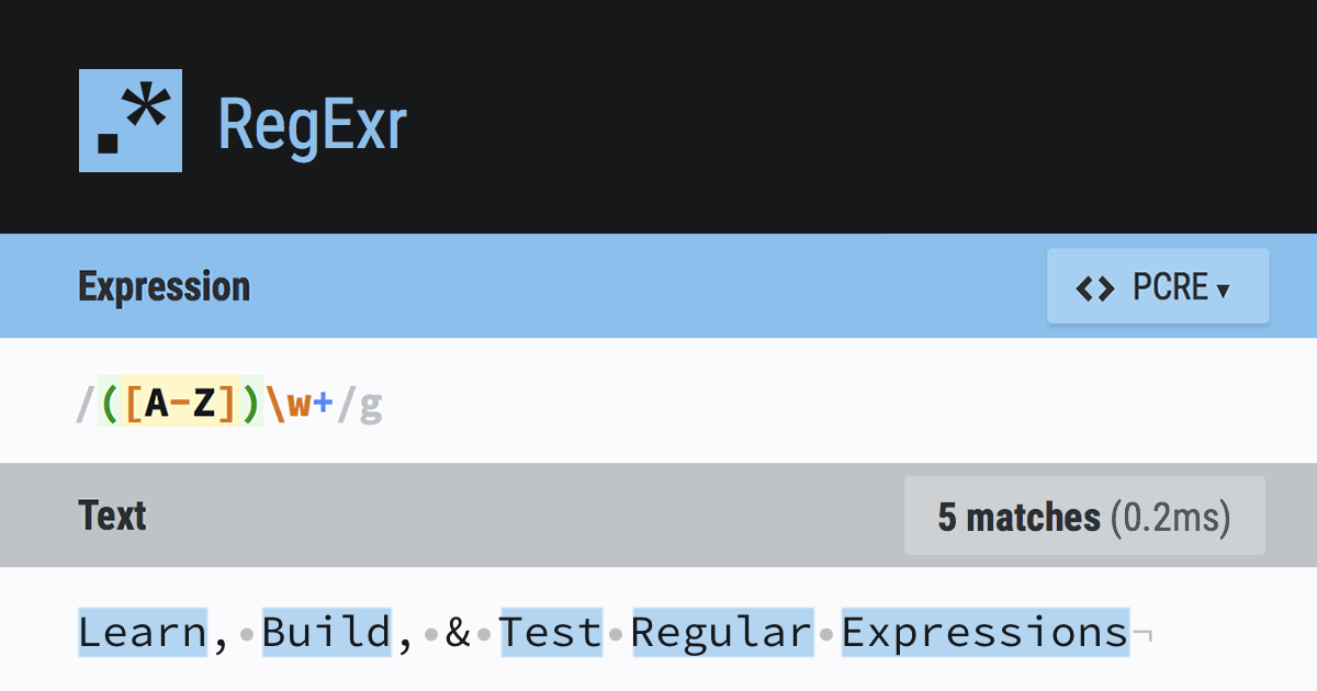

Wait, are you using this formula? RegExr: Learn, Build, & Test RegEx
Here's another one regex101: build, test, and debug regex
